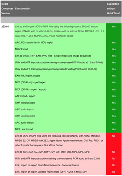

    Well, I just got off the phone with tech support and got my answer, although it wasn't the answer I was hoping for.  Here's what was E-mailed to me.
    "I was able to check the iPhone clips and it looks like a Catalina file format limitation and is currently not supported by Media Composer in this OS.
    "If you check the last item of the list from the link, linking, importing, and export of H.264 with Variable Frame Rate(VFR) in .mov or mp4 wrapper is not supported. The clips you provided are H.264 with VFR in .mov and .mp4 wrapper as you can see in the screenshot that I attached. You will need to revert back to Mac OS X 10.14.6 to use the iPhone clips."
    So I guess if I want to import/link iPhone .mov files, I will either have to use Apple's free iMovie or if I want to go for broke, purchase and install FCP.  I am familiar with FCP, that was my first non-linear editing application before I switched to Avid MC.  At least I can still use my Canon camera .mov files with MC.  I did adjust the video settings in my iPhone, though I don't know if that's going to make a difference.
    I attach two screenshots.
    In the first one, the last line applies to me.
    In the second one, the highlighted line shows the iPhone .mov file in question is of a variable frame rate, something MC does not support in Catalina.  This is all part of Apple's decision to no longer support QuickTime.
    Hopefully this will be helpful to someone who experiences similar issues.  So if you haven't installed Catalina yet, take my advice, don't!  Stick with Mojave.
