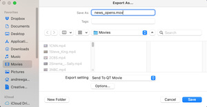

    This is where I am trying to output it to.  Is the "Export setting" correct?

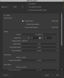

    This is what my video settings in MC look like.

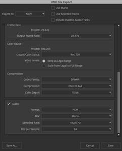

    This is what my audio settings in MC look like.

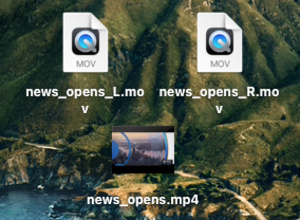

    Finally, as you can see the top two, the output icons come out in twos, left and right, with no video.  I want it to come out like the single bottom icon, either .mov or .mp4

    Your MOV export settings appear to be OK (but mono). However, you seem to be using the 'Send to QT preset. Which means MC will output at whatever (QT) options were recorded under that 'Send To' option. Looks like that Send To preset included Stereoscopic options (hence the L and R eye files).
    I'd avoid Send To.
    Simply use File->Export to File, choose Options, choose MOV, set settings as you desire, hit Save As, choose a name for this preset (so you may invoke it again later), and choose Export.
