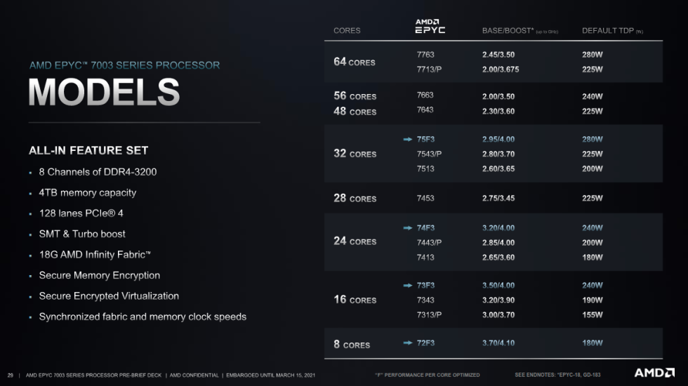

    Normal 0 21 false false false DE-AT X-NONE X-NONE
    AMD released new Epyc server CPUs today, looking very good, now we can have
    Cores and turbo and plenty pci-e and ECC and good price.
    my approximations
    the better 16 core epyc costs about a grand, is about 30% faster than 16 cores from intel while half the price of the Xeon.
    Or the same price for server parts as intel charges for consumer grade, while using 30% less power.
    And we can be 95% sure Avid will work great with them,
    they have north and southbridge on the CPU now, 30w less power, less compatibility issues ahead.
